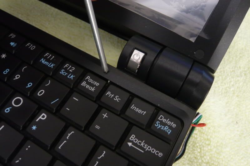

Flip the laptop over. You will now want to remove the keyboard. With the card, release the keyboard by shoving the metal clips between Pause/Break and Prt Sc, on F7, and between F1/F2. This should be easy- as you release the clips, use your fingernails to keep the keyboard from falling back in place. DO NOT PULL THE KEYBOARD AWAY YET- LIFT the top part up! You will remove the ribbon next.
Posted Image
Using your screw driver, look for these tiny black clip things on the side of the ribbon. There should be a small groove in each one. Stick the point of the screwdriver into there and push outwards on both sides. This should release your ribbon and you can pull it out with NO effort. If it still won't come out, move the black piece further out.

Yes, that touchscreen is the one I received from dealextreme. However, I received the 4-port usb hub rather than the thinner controller, so YMMV with this order. I have heard that people received either the 4port or the one in the picture.
As for the touchscreen ribbon being on the RIGHT side, this actually makes things much less complicated.
With the ribbon running through the right joint, you no longer have the power jack in the way, so you can run the ribbon through without worrying about wear and tear (asus engineers thought of that too-they have the black and white wires running through this area as well) This also eliminates the need for running a wire underneath the fan, as you will only have the two squished between the fan and the HD enclosure.
This guide will not work with the 900A; jkk mobile has the 900A guide. The mobo has several differences that will allow you to place the controller elsewhere more easily than in the RAM bay (not sure if it has space there anyways) This guide is specifically meant for the 900HA.
Photos forthcoming. The quality is fairly decent, I believe. Only on low backlight conditions can you really tell there's something in the way.
EDIT- photos and a video are up showing the result of touchscreen installation. Note that my camera adjusts for the brightness so it appears darker anyways when I turn up the brightness. I'm overall pleased with how inconspicuous it appears to be, at the very least.
